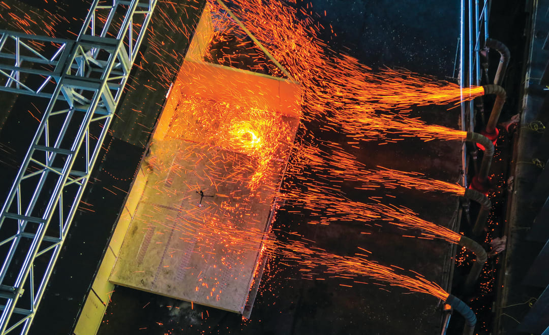

Wind-blown ember exposure to an attached deck during an experiment to evaluate the vulnerability of decking products to an ember ignition at the IBHS Research Center.

Most major wildfires are aided and spread as a result of strong winds. The IBHS facility replicates those conditions in their chamber through ember creation and fire testing, using seven ember generators that blow various sizes of burning wood embers. This testing creates awareness for the damage wind-driven embers can inflict on wood structures and communities. Understanding the mechanism by which burning embers can enter through roof and eave vents is paramount in modifying a design that will survive such an event.
