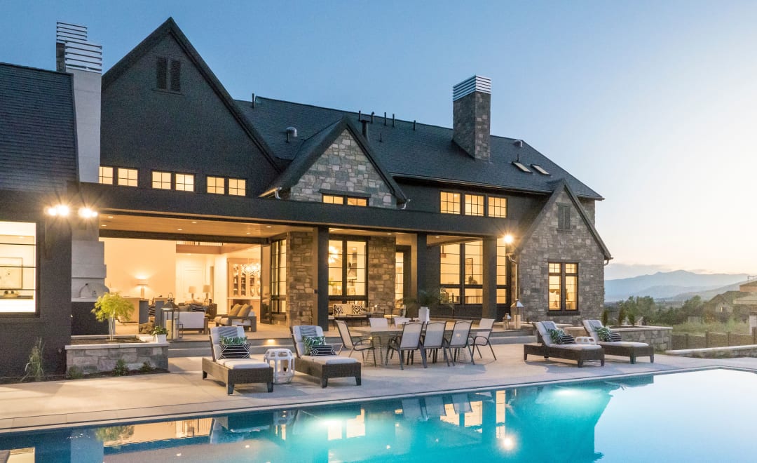

Andersen Windows - Movable glass walls
When open, folding doors, such as this model from Andersen’s Architectural Collection, fold up to beautifully frame the view. When closed, they create a stately wall of light.
