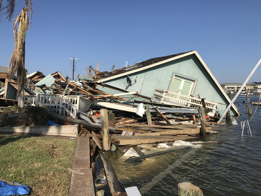

A two-story condominium collapsed in high winds when storm surge undermined its foundations.

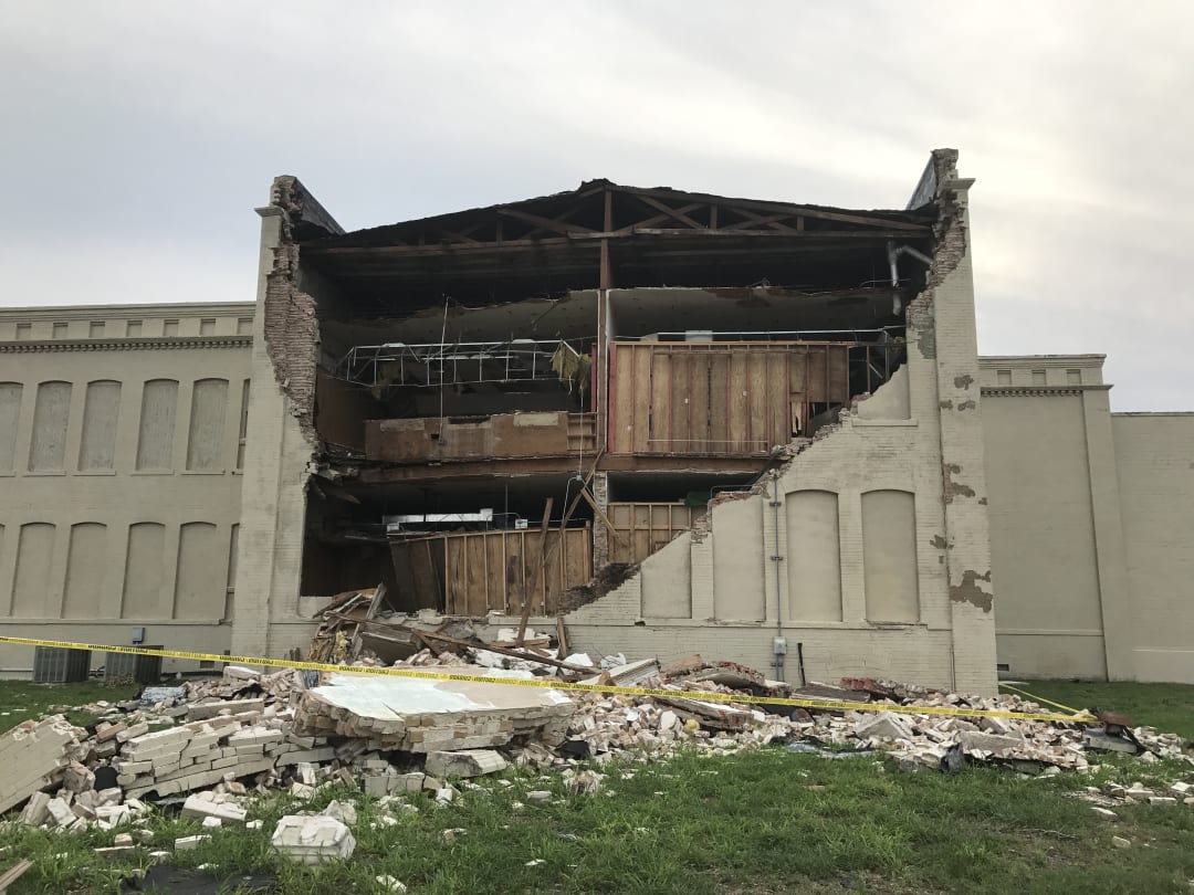

Wind damage seen after a hurricane is similar to that caused by a tornado and water damage is akin to the impacts of a small tsunami or flash flood.  High winds can create varying degrees of damage within a community—ranging from the loss of some siding, windows, or gutters, to the complete collapse of a structure. After Harvey, homes that still looked brand new stood alongside foundations that were wiped clean.
As the storm came ashore its winds switched direction, lifting roof shingles, damaging decking, and bringing suction forces that tore stone and brick veneers from facades. Such impacts often stem from inadequate detailing such as a lack of hurricane clips and other connectors, poorly attached shingles, inadequate bracing of first floor pier-and-beam systems, and poorly installed masonry anchors.
Water can be just as vicious as wind. In the structures we assessed, roof leaks led to ceiling collapses, and interior flooding created a breeding ground for mold. As waves surged onto the shore, they tore away sections of structures that had not been elevated, scoured foundations and streets, and washed away entire buildings. Breakaway walls under elevated structures protected the structures they were a part of but also yielded debris that impacted neighboring unelevated homes. We noticed that water damage can be exacerbated by a lack of secondary water barrier like taped sheathing joints or poorly-installed chimney caps and chases. When those elements aren’t intact, water can pour into a structure very easily.

High winds destroyed the side of an Aransas Pass Independent School District office building.
