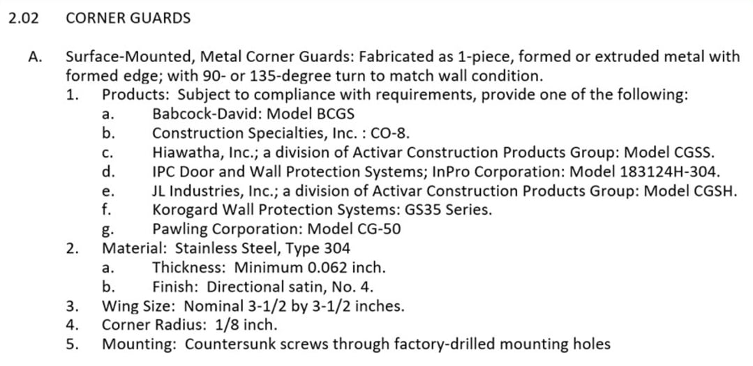

This may seem obvious. After all, it is called a specification for a reason. But not every spec spells out material. Let’s compare two real-life specification examples, shown in Examples 1 and 2, both specifying corner guards.
Corner guards are made in a variety of different materials: PVC, PVC-free plastic, acrylic, polycarbonate, stainless steel (Type 304 or 316), aluminum, or brass, all of which have different sourcing and installation costs. Imagine you’re a contractor reading the spec in Example 1. With no indication of material, you will likely need to submit a Request for Information (RFI) to get clarification from the designer in this case.
Now look at Example 2. This designer used MasterSpec, a product of AIA and developed by Deltek. In this spec, the material is clearly listed, and it’s specific. Stainless steel, Type 304. No guessing and no RFI required. This saves time and ensures the contractor will purchase and install the specific product you envisioned.

In Example 1, it appears the designer had a certain product in mind (BCGUS3S), but a quick search on the Babcock-Davis website shows us that there is no product with that model number. A smart contractor is going to use this as a chance to submit an RFI. The designer was most likely referring to model BCGS, which we can see is properly specified in Example 2, having been pulled directly from MasterSpec content and confirmed on the manufacturer website.
In addition, if the contractor wants or needs to make a product substitution, Example 2 provides enough information to safely and accurately make that swap. In contrast, the Example 1 spec leaves too much to the imagination and can lead the contractor to make design decisions that should be made by the architect.

Continuing with the corner guard example above, the specification in Example 1 is ambiguous in terms of installation. After reading the spec, we don’t know if the product is intended to be held in place with adhesive or screws. Not only does this leave the contractor unsure of what materials to procure, but it also doesn’t allow him or her to gauge how much time and labor this will entail. It’s very likely this lack of detail will result in an RFI.
The “good spec” in Example 2 paints a clear installation picture, identifying the mounting mechanism as countersunk screws through factory-drilled mounting holes. By requiring factory-drilled mounting holes, we know the architect is going for a very clean, finished look. The contractor can plan accordingly and go straight to the manufacturer to purchase supplies while knowing exactly what this will entail for labor during the build.
