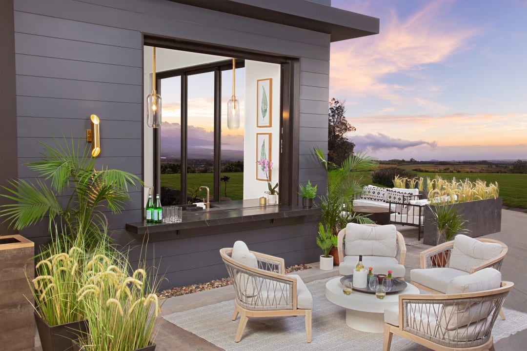

Another more scalable option is to install pass-through windows, which take up less space than an open door but add that coveted connection to bring in more light and create an indoor-outdoor kitchen with a bar for entertaining.
Andersen's pass-through window creates a picturesque indoor-outdoor bar.
