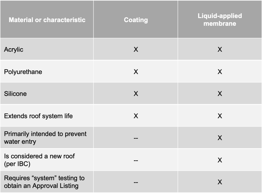

Let’s chart it
The following chart provides examples of similarities and differences between coatings and liquid-applied membranes.
Conclusion
Simply put, coatings are used to provide protection from the elements and help extend service life.  Coatings are not installed as “membranes,” so they are not intended to seal leaks or be considered “waterproof” or “weatherproof.”  Liquid-applied membranes are considered to be just that—membranes—and are used as the roof covering in both new and re-cover roof systems. Liquid-applied membranes are tested as systems and have Approval Listings just like traditional asphaltic, modified bitumen, and single-ply roof systems.
