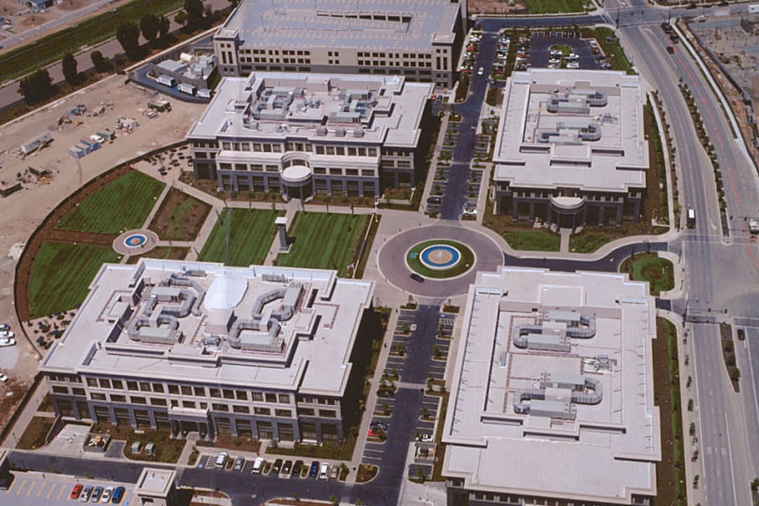

Concrete decks are one of the more common types of low-slope roof decks for commercial buildings.  While there are many advantages to concrete decks, there are two primary reasons to consider them—desired fire ratings and structural requirements.
