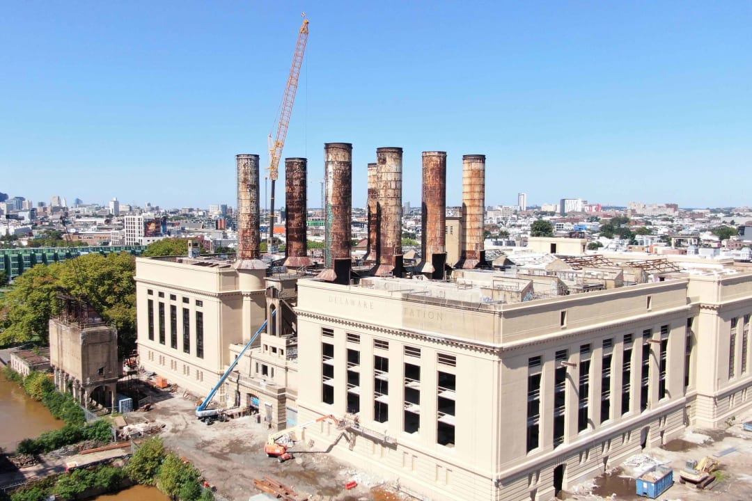

Upon completion of its adaptive reuse and addition, the former power station of the Philadelphia Electric Company on the Delaware River — now known as The Battery — will offer event space, a hotel, apartments, commercial space, and more.
The project hit a snag when the team identified damaged concrete surrounds in the 40-foot openings, each of which house 12 to 15 windows. Graham Architectural Products pivoted to replicate the concrete surround detail in its custom “unitized” subframe, which also enhanced water management and created efficiencies for the installation while improving thermal performance.
GAP utilized a similar unitized system for The Battery addition, then delivered the factory-assembled unitized receptors and window units directly to the panel manufacturer so the entire unit could be assembled and sealed for efficient installation.
