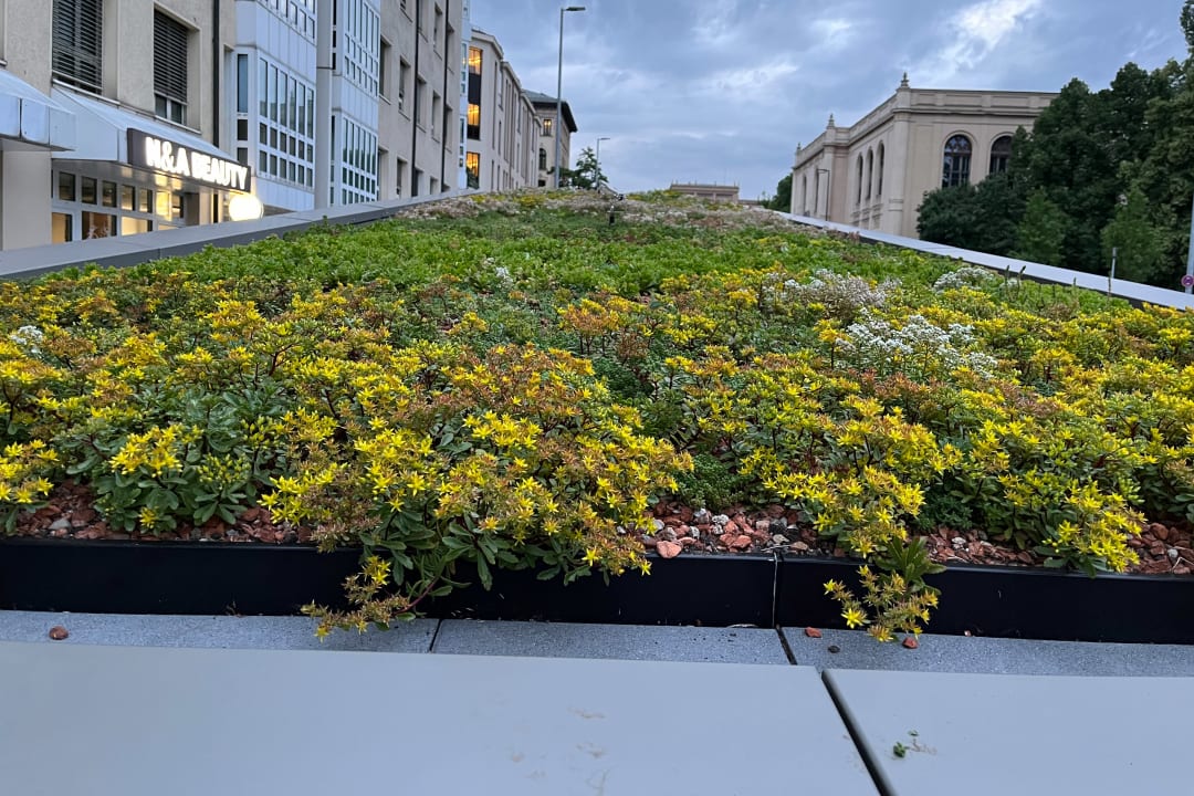

Overburden is material or equipment that is located above the roof assembly. While each property is unique, there are many overburden options such as vegetative roofs, blue roofs, blue-green roofs, purple roofs, and rooftop solar.
Roof system considerations
The overburden’s success depends on the roof assembly beneath. Failure of the membrane, whether it requires repair or replacement, may necessitate removal of the overburden. The removal of the overburden can result in lost energy generation for solar installations and loss of rainwater capture for both vegetative and blue or purple roof assemblies.

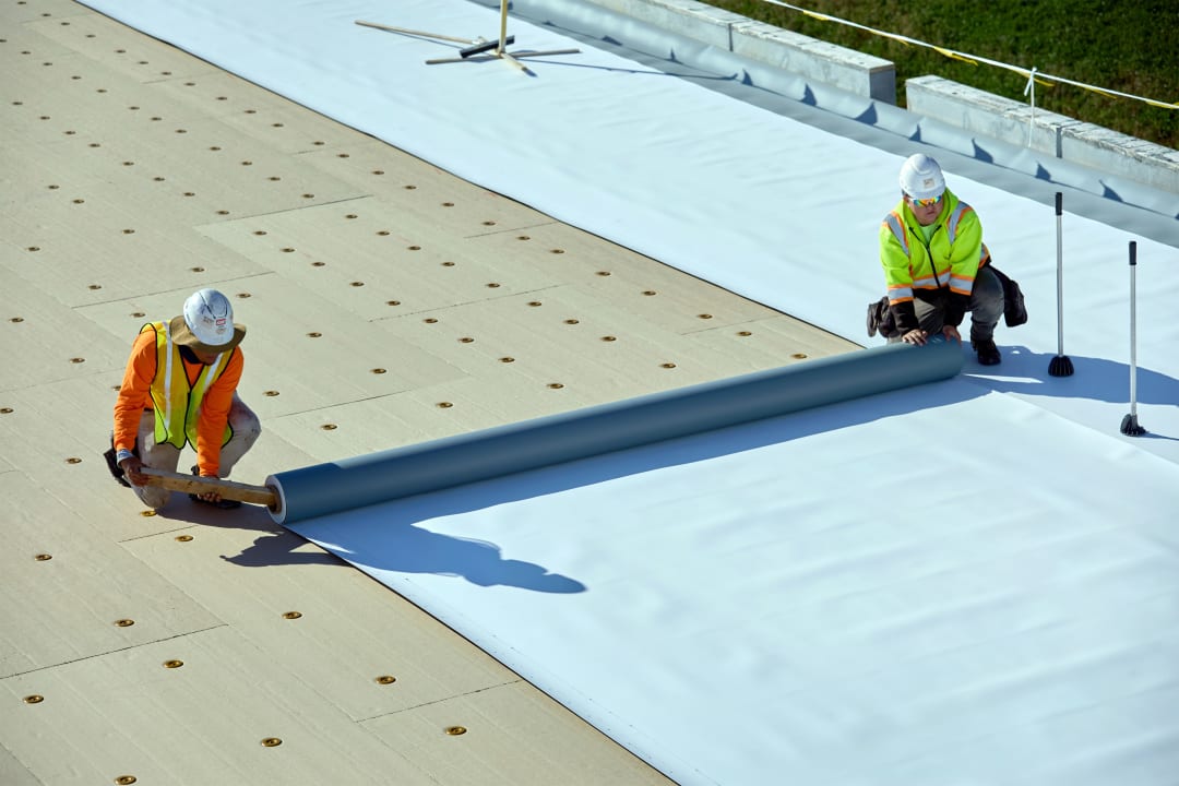

Both single-ply membranes and modified bitumen roof systems can be an excellent choice for overburden installations as there are a wide range of application options that can be tailored to suit each installation. The type of overburden will determine whether the membrane should be installed at the deck level or at the top of the assembly. Membranes that will be used at the deck level, such as for vegetative assemblies, should be evaluated for durability and longevity since access to them for repairs will be limited and costly. Membranes where overburden systems, such as solar, are installed directly on the membrane should be able to withstand abrasion and puncture from roof elements above it. For blue roofs and water catchment systems, single-ply membranes are commonly used at the top of the assembly, and it is recommended that they meet NSF P151 water potability standards.

The attachment method of the membrane, whether mechanically attached or adhered, should be decided. Mechanically attached single-ply systems are subject to billowing in high-wind events. Over time, billowing can cause stress and fatigue on the mechanical attachments and membrane. Overburden installed over mechanically attached systems may billow with the roof membrane during high wind events, causing abrasion of the membrane surface. The overburden may also experience stress and fatigue due to movement, which could decrease their overall service lives.

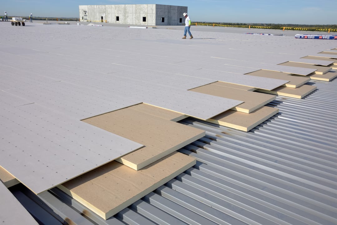

Insulation
Insulation is critical in roofing assemblies for overall energy efficiency of the building. The higher the R-value, expressed per inch, the better the thermal performance of the insulation and its effectiveness at maintaining interior temperatures. Higher R-value per inch means less material is required to achieve the desired insulating value. Insulation boards are required by code to be installed so that the joints are staggered and offset, and several layers of insulation should be installed rather than just one thick layer.
Coverboards
Inclusion of a coverboard must be considered after selection of the overburden. Rooftops with overburden assemblies generally have increased foot traffic on the roof. Coverboards provide added protection against added foot traffic, penetrations (including from tools dropped by service contractors), wind-borne debris, and hail.
