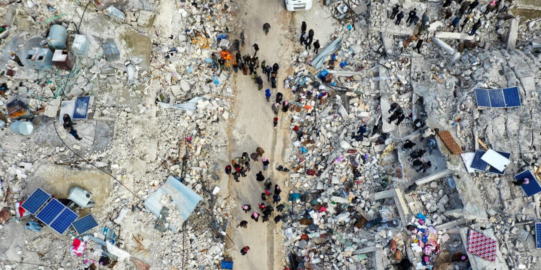

The destruction from the current quake is similar. The hardest hit 10 provinces stretch approximately 500 kilometers. This is almost the same distance from Boston to Philadelphia or New York to Washington, D.C., in the United States of America or Paris to Amsterdam in Europe.
Turkish cities experienced rapid industrialization and urbanization due to population growth and an increase in density after the 1950s. Most of the cities lost their low-rise, single-family traditional houses and they were replaced with mid-rise multifamily buildings. The typical multifamily housing stock in most of Turkey including in the quake-damaged disaster area consists of approximately four- to ten-story reinforced concrete buildings with brick or concrete masonry unit non-load-bearing exterior walls and interior partitions.
A very high percentage of the residential buildings, 60% or more as miscellaneous authorities report, are built without proper permits or with no accordance with building codes. The earthquakes would be less destructive if seismic codes and geological surveys had been implemented properly and settlements were not allowed on the fault lines, and corrupted construction processes with weak control of constructions prevalent in Turkey’s construction sector were abandoned.
