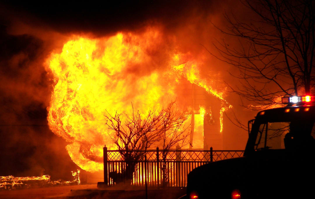

According to data from the National Interagency Fire Center, in 2016 wildfire destroyed 3,192 homes across the country.
In this story from AIA partner James Hardie, find out how architects can use their products to enhance fire safety
California architect Annie Chu, FAIA, begins each new project in the same way. Chu uses an online system to investigate the home site’s fire risk and the measures required to mitigate it.
Prolonged drought and steep topography surrounding Los Angeles, where Chu works as a principal of Chu + Gooding Architects, make the area particularly vulnerable to wildfire. But it’s not just Californians who face risks.
In 2016 wildfires destroyed 3,192 homes across the country, according to data from the National Interagency Fire Center. Tennessee, site of the Gatlinburg fires, was the hardest-hit state, with 2,121 homes lost.
And this number is probably low because of gaps in the way federal and state agencies and local fire departments collect data, explains Michele Steinberg, manager of the Wildfire Division of the National Fire Protection Association, a nonprofit organization that creates codes and standards used by local governments and firefighters.
“The trend over the last 25 years is for the severity of fires to increase,” Steinberg says. “We aren’t necessarily seeing more fires every year, but we are seeing bigger and bigger fires.”
With erratic global weather patterns, “There is a risk everywhere across the United States,” Steinberg says.
While many people envision the destructive power of a raging fire, the real threat comes from embers that float through the air before and after fires—as many as six embers per square foot, says Bill Stewart, co-director of the Center for Forestry and Center for Fire Research and Outreach at the University of California, Berkeley.
