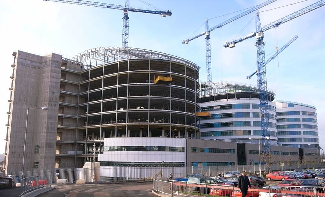

Birmingham Super Hospital
Wikimedia Commons / Oosoom
