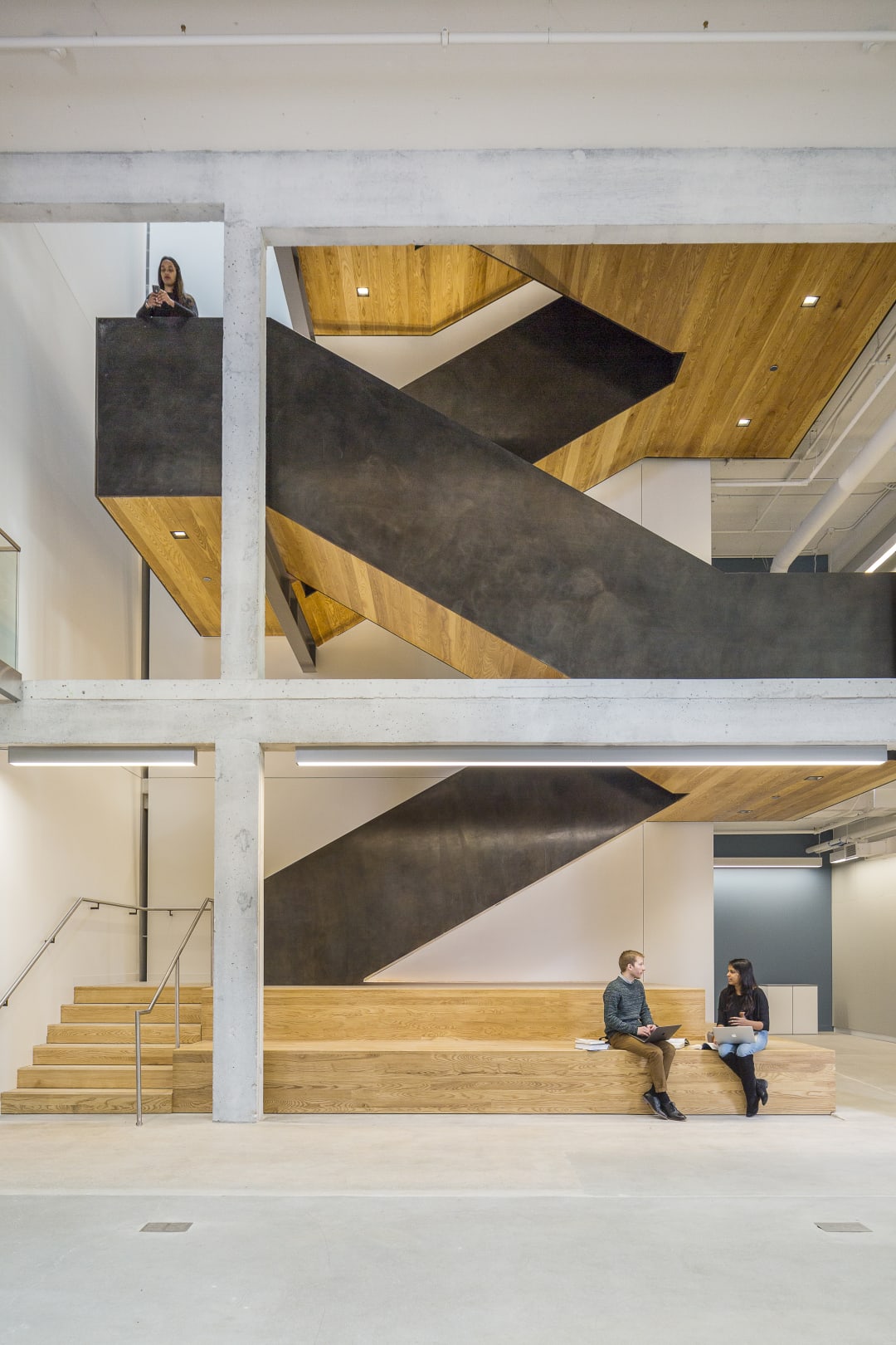

Monumental stair

"The opening of the floor plates to create a larger light-filled community atrium makes the interior expansive. This design intervention teaches us an important lesson on how to transform these large floor plate-existing buildings into healthy, desirable, light-filled spaces." - Jury comment
The expansive concrete structure had restrictive floor heights and offered little connection to the exterior. Extensive daylight analyses helped balance perimeter windows with daylighting in the east and west two-story atria. A larger central four-story atrium was carved into the building and serves multiple programmatic functions.
