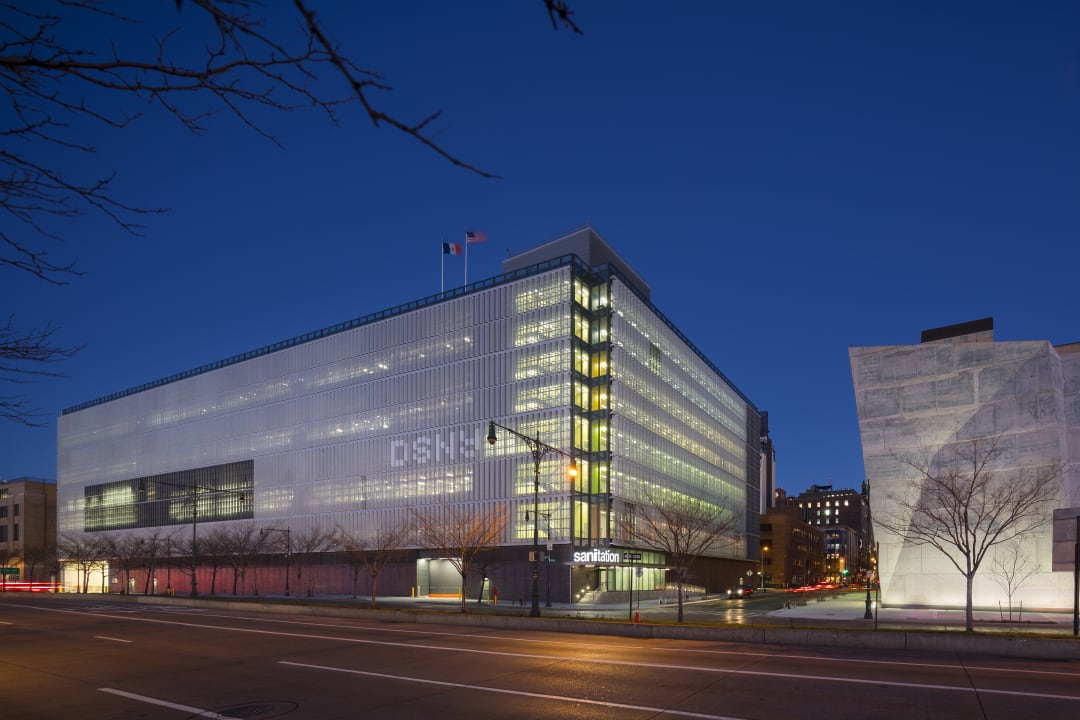

The Garage and Salt Shed celebrate the role of civic infrastructure by integrating architectural design with sustainability and a sensitivity to the urban context. The building is wrapped in a custom perforated double-skin facade that reduces solar gain while allowing daylight and views in personnel areas. The 1.5 acre green roof protects the roof membrane, reduces heat-island effect, enhances storm water retention and thermal performance, promotes biodiversity of native species, and softens the view from the surrounding buildings.  This harvested non‐potable water supply from the roof's storm water and waste steam condensate from municipal steam used to heat and cool the building are used as a source for flushing restroom fixtures and for truck wash. The Garage is a key project for NYC's Active Design Program, promoting health and fitness of occupants through building design.
Image: Albert Vecerka/Esto
Within the year of opening the Manhattan Districts 1/2/5 Garage & Salt Shed have become a source of neighborhood pride. This pair of public buildings, that serves close to 300,000 residents, are the home for 150 sanitation vehicles, 3 districts’ equipment including front-end loaders, salt spreaders, heavy-equipment wreckers, personnel vehicles; separate vehicle wash, and 250 workers who have offices, locker rooms, training and lunch rooms for each district; centralized fueling and repair facilities and 5,000 tons of salt for winter snow clearing.
As the first LEED rated Department of Sanitation facility, an interactive and iterative design process was critical to establishing project goals. The team worked closely with DSNY and a Community Board approvals process, through a series of workshops to develop the program requirements for a vertically organized multi-district garage. Through this process, opportunities were identified for combining shared spaces, reducing floor to floor heights, and optimizing circulation efficiency.
Innovative architectural design components were integrated for their contribution to sustainability goals, promotion of employee health and wellbeing, and response to the urban context.
A double-skin façade wraps the upper floors of the garage, comprised of glazed curtain wall and 2,600 custom perforated-aluminum solar shading devices (“fins”), which float above the building’s dark articulated masonry base. The fins reduce solar heat gain and glare, create an ethereal wrapper to obscure mechanical louvers and shield the view of headlights from neighbors.
The Salt Shed’s crystalline, faceted architectural concrete planes enliven this highly visible structure, creating a sculptural landmark in the neighborhood. It tapers toward the bottom, creating more pedestrian space and emerges from a moat of textured glass paving, which reflects the sidewalk illumination.
The end result was a pair of buildings with a smaller volume to mechanically ventilate, a contextual massing, and elements of urban delight and curiosity.

"The project achieves two extraordinary feats: It raises the bar for a municipal sanitation building to the status of an excellent civic structure in the heart of the city, and it also evidences extraordinary skill in changing an initial negative community response into a welcoming presence. The green roof participates as a building system by providing a habitat and food for migratory birds, capturing 100 percent of rainwater and improving views for neighboring buildings. Greywater is used as a source for flushing restroom fixtures and truck washing. Attention to its civic responsibility is shown in the cost-effective paint color palate, which creates a polychrome façade at night. The salt shed is an unexpected sculptural element, creating visual interest in an industrial context and demonstrating investment in an underserved neighborhood."
