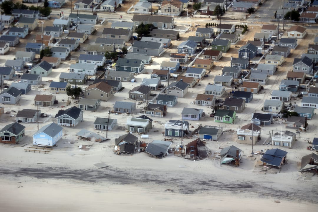

Hurricane Sandy devastated communities throughout coastal new jersey in 2012. By taking advantage of state, local, and federal resources, architects can contribute to mitigating climate and hazard risk in the built environment.
